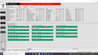

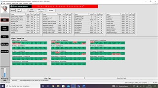

I got two problems with the BQ20z655 at low temperatures, first I don’t understand why at temperatures below JT1 (-10°C in this case) the Charge-FET isn’t switched off and second when I start charging with a normal laboratory power supply at room temperature, then during the charging I cool the battery down to e.g. -20°C and during this process a SOC of 48% is reached, directly after pulling the battery out of the charge or disconnecting from the power supply and inserting in to the application the SOC jumps down to e.g. 4% although the max current peaks form the application are around 150mA. Which shouldn’t have a big impact on the SOC of a battery with 3300mAh after such a short time.
After charging:
After about 2 min in the application:

  • Hello Tobias,
    The bq40z50 is more accurate at low temperature compared to bq20z655-R1. There are very few adjustments available on bq20z655-R1 for cold temperature.
    I would recommend that you use the GPCRB tool to improve low temperature performance. Another factor that is applicable is that bq20z655-R1 expects charging temperatures to be more stable. There is no compensation for drastic changes in temperature during charging. Also note that the battery capacity at -20C is very low in terms of maH even though percentages may be the same. That may be the cause of the drop.
