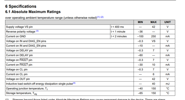

    Would you try to tie the Delay pin at 24V circuit to 3.3V and see if you still see a constant low fault? The abs max for the DELAY pin is 7V. Also at this point I'm not sure if the device is damaged by having too large voltage at DELAY pin. It might be worth a while to replace a new IC and test the 24V case again.

  • Hi Yichi, thanks for the reply. Maximum PIN delay voltage was my first idea. I replaced the chip with a new one and I brought the pin delay to 5Vdc, but it still didn't work. Also from the datascheet you will find this example:
    in this diagram the delay pin is connected to Vs through an R100K and Vs can reach a maximum of 40V. If I power the circuit at 24Vcc and measure the voltage on the delay pin is less than 7Vcc despite the RUp at 24Vcc, I believe that the pin internally keeps itself below the maximum 7V protected by the R100K.
