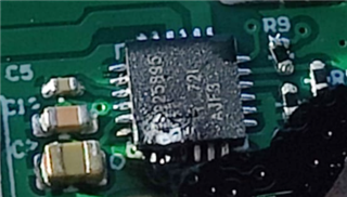

BQ25895: We have had issue with exploding chip (chunk out of body is 'blown off' - see attached picutre)
Part Number: BQ25895
Other Parts Discussed in Thread: BQ25890,

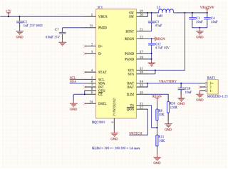

Its very strange - the design works perfectly in normal operation (and does on numerous other designs).  Its only on attaching/detaching wires from Lab supply during testing.
However this one is a 12V design and this only occurs when we connect / disconnect the wires seperately from lab power supply.  Also noticed when input wires were accidentally shorted together when disconnecting from lab power supply
It also happened on the BQ25890, so I thought it might have been the input wires shorting and OTG, but obviously the BQ25895 can't do that.
