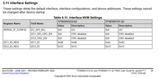

  • Watchdog function register(0x401~0x40A)
    0x401~0x40A are in the address 0x4C?
  • 0x401~0x40A are in the address 0x4C?
    If you are using the TPS65941212EVM then the I2C2 address is 0x12.
    Page 0 -> 0x48
    Page 1 -> 0x49
    Page 2 -> 0x4A
    Page 3 -> 0x4B
    Page 4 -> 0x12
    In the PDN solution, https://www.ti.com/lit/ug/slvuc32b/slvuc32b.pdf#page=21
    Also the I2C2 is physically located on GPIO1 and 2 for this configuration.
    Whenever the I2C2 functions are enabled on GPIO1 and 2 then the PMIC will use I2C2 for the PAGE 4.  If not then I2C1 is used.
