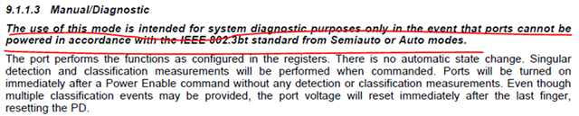

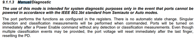

    Thanks for helps. I checked the D/S, it seems any detection or classification are disabled in the manual mode. So how about the overcurrent protection functions? Does this still achievable?
    Stanley
  • Hi Stanley,
    Yes. Overcurrent protection is still available in manual mode. Thanks.
    Penyy
  • Hi Penny,
    In summary, customer still has concerns about the manual mode. Because our D/S indicates this mode is only for the diagnostic purpose. Pls double check again below customer demands can be achieved or not by our TPS23881. I also will reach to u if a webex call is needed between customer and BU.

  • Hi Stanley,
    Yes. Manual mode can be used for their nonstandard application.  This is considered as "ports cannot be powered up in accordance with IEEE802.3bt standard from semiauto or auto modes".
    Voltage/current monitoring and overcurrent protection are all available in manual mode. They can order TPS23881EVM to do some testing for evaluation. Thanks.

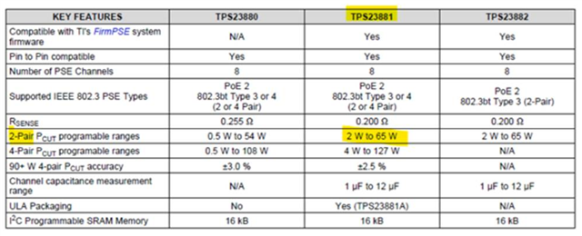

    1. In manual mode, for 2-pairs application our TPS23881 can achieve 65W in maximum shown in below D/S, right? Or we should leave some margin here?
    2. In Manual mode, how to detect whether is there PD device plugged in? Customer needs to know so they can send power enable command.
    3. For power policing functions, why 0x1E register s becoming to all "F" value (equal to "127.5W") when triggering over-load protection?
    Stanley
  • Hi Stanley,
    1. The 2pair PCUT tolerance is shown on datasheet.
