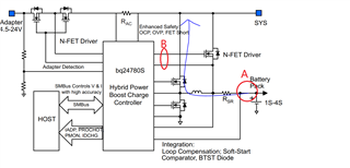

Hi, Team,
We are  using the 4S battery with the full voltage to 16.8V and need to close the battery when the 14V  ACIN is supplied.  We  prepare to change the BAT FET to the dual FET as the AC FET which will block the body diode current. But per our test , the BAT FET can not close when the 14V ACIN  is supplied untill the ACIN voltage rise to 17.8V.  How to modify the circuit?
Could you give some advise on it?

    BATFET cannot prevent battery discharge current because it will go through the body diode even when it is closed.
    BQ24780S is a buck charger, the input is never supposed to lower than the battery voltage. It may be difficult to accommodate to all the operations if you continue down this path. For example, 14V input available, the BATFET turn off/switch over timing may be hard to achieve even if you add a dual blocking FETs.
    I would recommend looking into the BQ257xx buck boost series.

  • Hi Tiger,

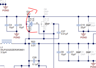

    I think it will be difficult to anticipate potential issues if your VIN is lower than battery voltage. For example:
    Even if the BATFET path is fixed, there is a path from battery -> inductor -> high side FET body diode back to the SYS input. The inductor is short at DC.

  • Hi Tiger,
    In my opinion, BQ257XX buck boost controller is your best path forward. Many customers have used it in complicated and potentially sensitive applications.
    As I mentioned before, I do not recommend using BQ24780S with VIN < VBAT. Even if we ignore the BATFET modifications required (whether or not that is possible is another discussion), the high side switch path body diode cannot be fixed. Inductor is short at DC.

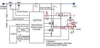

  • Hi, Peng,
    Many thanks!
    I saw the path in your circuit, but I means to add the N-FET in A point of my circuit and share the BATDRV with the existing BAT-FET. When the ACIN supplied, short the B point by a small P-FET  to close the BAT-FET.
    Can it work?

  • Hi, Peng,
    Many thanks!
    We just want no switching when in normal mode.
    Per my new circiut, there have a issue  when in charging mode , that as the N-FET added  is between the BAT and the charging FET and the BAT-FET is closed when charging, so there always have a body diode in series with the BAT, which will shift the end point of charging voltage. If we still set the charge voltage to 16.8V, the battery will never be full charged.  How to work around? Would like to have your advice.

  • Hi, Peng,
    Many thanks!
    Please refer to the attached circuit, the added NFET is  for blocking the battery when ACIN supplied and the BATFET is closed when charging , so there should be a body diode in series with battery..
    Could you give some advice on how to compensate the charging voltage shift by the body diode of the N-FET added  between the BAT and the charging FET?
