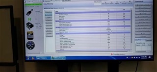

    For sub-Li-Ion 2-string 36Ah, 30 mA continuous discharge. After the board is calibrated, the power is removed, and the board is connected to the battery with a 1-A load, and the current on the upper computer is not responding, and the voltage cannot be corrected. It is needed to click on GAUGE STSRT to display the current, calibrate the voltage, and if click on GAUGE stop, the current does not respond.
    However, as per the spec, after calibration, it needs to be turned off by clicking gauge stop. But the voltage current does not change after switching off. So can SOC be seen at discharge?

    It's connected with the EV2400, upper computer Battery management studio version 1.3.110.
    Is it needed to click "gauge stop"? The gauge doesn't seem to work after turning it off.
    The bq35100 can operate in 3 separate modes (ACC, SOH, EOS)
    How to configure these 3 modes? It looks like there are only EOS in the setup, the other two are not. Regarding sub-lithium cells, which one is the best choice?

  • Hello Cherry,
    The image shows that it is in accumulator mode. See Operation Config A in TRM for details
    To read voltage/current first send GAUGE_START. When done reading, send GAUGE_STOP

  • Hello Cherry,
    Calibration is a one time requirement.
    Gauge_Stop is sent to conserve power in normal operation when there is no load.
