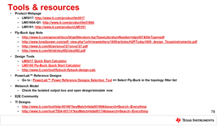

  • Hello
    I think you may need to consult your transformer manufacturer to see if anything can be done
    to reduce your leakage inductance or make it more predictable.  Also, be sure that you are using
    a Schottky diode or an ultra fast diode with low Trr.
    I have attached a page of resources that you may find helpful.
