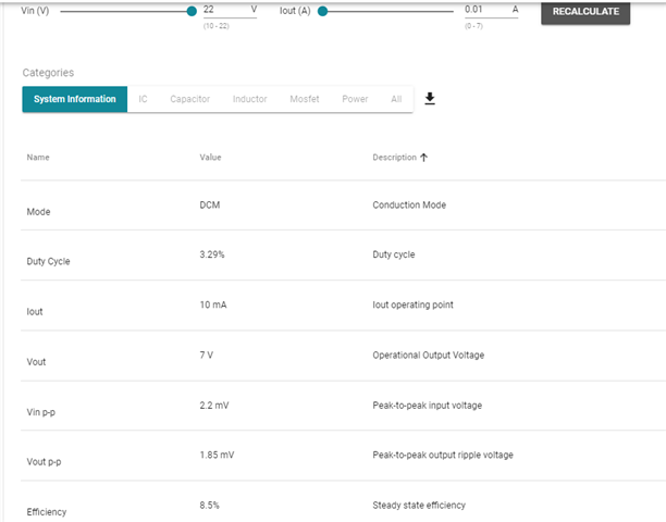

(2)What is the efficiency at 10mA?
LM25145_Diode_Emulation_Mode_ON.pdf
Hi
wenbench actually can predict the efficiency at your target loading condition, as wenbench sim, it will be 8.5% .
The input power will be major consumed by IC and mosfet gate drives which make the efficiency low.

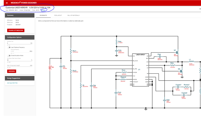

Daniel Li14-san
Thank you,
The minimum temperature when calculation is unknown.
Does it has how to Confirm.
Is it possible to change?
