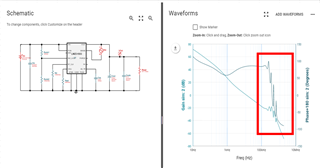

When LMZ31503 simulate the bode plot on Webench with Cout: low ESR setting, waveform was unstable.
Please see attached below (Cout: 100μF / 2mΩ ×2. Coutx: 47μF / 2mΩ ×4, fsw: 680kHz)
Webench link: https://webench.ti.com/appinfo/webench/scripts/SDP.cgi?ID=3D54F635C795F44C
By the way, when Cout's ESR increase to 25mΩ, waveform was stable.
When Coutx modify total capacitance and ESR and Qty, waveform was stable, too.
Please let me know why Cout setting become unstable and the division of roles on Cout and Coutx.
I want to know why bode plot simulation correct to set Coutx value, not set Cout value.
