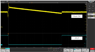

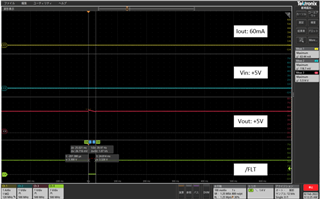

Although TPS26601 operate 5Vin and 63mA, /FLT pin output is asserted.
I referred below application note and add current limiting resistor: 3kΩ, but /FLT assert was not disappear.
(Blocking diode can not add because of board size)
https://www.ti.com/jp/lit/an/slva934a/slva934a.pdf
I guess that above problem have the other reason.

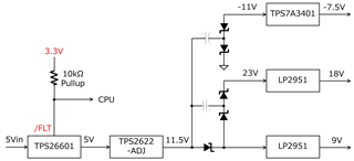

②Is current limiting resistor value based on Vin, correct?
 If Vin is differ from VIO voltage (ex. Vin: 5V and VIO: 3.3V), which based voltage correct?

・/FLT output is connect to CPU input, 3.3V with 10kΩ pullup.

  • Hi Satoshi,
    FLT/ assertion might be due to reverse current fault trigger.
    Few questions: In your test waveform, why there is a jump in Vout ?
    what is the load type?
    Is Vin at 5V ?
    Rakesh
  • Hi Rakesh
    Thank you for reply,
    ・Load (output) side is connecting Boost DC/DC: LM2622, 5Vin ⇒11.5Vout.
    ・Sorry, blue waveform is unrelated, Vin is 5V.
    ・The reason for Vout jump is confirm and feedback later.

  • Hi Satoshi,
    since Vout has jumped and created a situation of Vout>Vin, reverse current fault might have triggered.
    Is this issue happening only at light load ? or at higher loads also such as 1A, 2A etc ?
    Rakesh

    I attached power block diagram.
    LM2622 is always enable: ON, timing for this issue happen is Enable: OFF → ON for TPS7A3401 and LP2951 ×2.

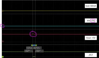

  • Hi Satoshi,
    The switching noise of the load might be affecting the eFuse operation and triggering reverse current fault. Can you increase output capacitance of the eFuse and check the behavior.

  • Hi Rakesh
    Thank you for advice,
    Zoomed waveform is attached below;
    ・Cout: 47μF, Vout_min: 4.66V ~ Vout_max: 5.56V
    ・Cout: 47μF ×4, Vout_min: 4.66V ~ Vout_max: 5.31V
    I continue to request the test for much more Cout value.
    I'll feedback to you later.
    Satoshi
  • Sure Satoshi.
    Can you also check the reason for the dip in the Vout.
    Rakesh
  • Hi Rakesh,
    Please see additional information below;
    ・When output capacitance increase 47μF ×8, but Vout jump have not reach Vout>Vin +10mV.
     And customer can't add more capacitance value because of board size limitation.
     ※Cout: 47μF ×8, Vout_min: 4.717V ~ Vout_max: 5.262V

  • Hi Satoshi,
    The issue remains even if we replace TPS26602 with TPS26601
    One option to solve the issue with out increasing the output capacitance is using devices like TPS1653, TPS1663. These devices does not has reverse current protection and are ideal for your application.
