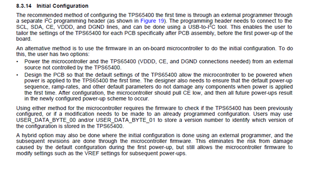

Customer wants to use SS1/PG1 pin as Power Good. And they have questions as below.
1. Are there any ways to use SS1/PG1 pin as Power Good at default?
2. I guess, it is impossible to use the pin as Power Good at default. As the alternative way, can they use EEPROM inside the device in order to set the pin as Power Good as defalt every time the device is powered on?
3. What is the requirement when they reconfigure the pin through I2C?  For exmple, if VIN is more than 4.5V, can the I2C communcation be established?
