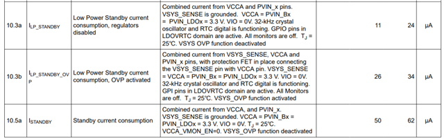

Recently my customer is testing the power consumption under different states. We have one question below,
1. What is the difference between Standby and LP Standby? LP Standby mode consume less current compared with standby mode, so which part is disabled in LP standby mode while enabled in standby mode?

  • In LP_STANDBY mode, the internal LDO is disabled. This is represented by VOUT_LDOINT pin.

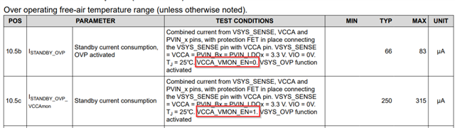

    My customer is testing our PMIC's standby current. Currently the test result is larger than 300uA which should be in 10.5c status. My customer wants to decrease the current to the level of 10.5b, so they set VCCA_VMON_EN=0, but the current is still around 300uA which seems no change.
    If we want to achieve the current of 10.5b, Do other registers need to be set? Their current register setting is as below.

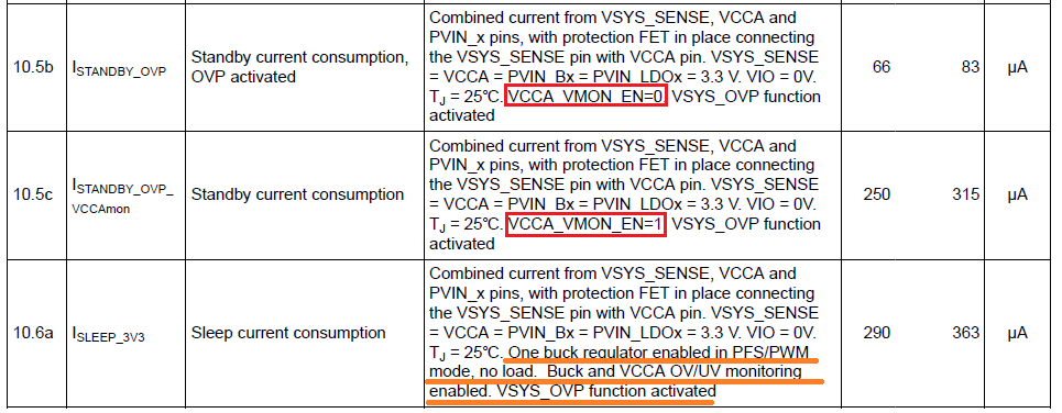

  • Hi Michael,
    Thanks for your reply!
    I understand your point. But I still have some confusion for below table. Comparing 10.5b and 10.5c test condition, the only difference  is the setting of VCCA_VMON_EN, so I think VCCA monitor function will consume 250-66=184uA current, which should be independent of the measured point.
    In customer's test condition, when they change VCCA_VMON_EN bit from 1 to 0, the current hardly changes. My customer is computing the total solution sleep current consumption, so they have to test the current at 6594's input VSYS, the smaller the better. How do we operate to reduce the current below 100uA?

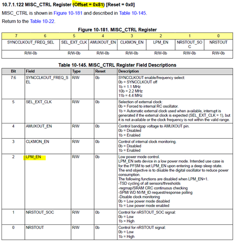

  • Has the customer tried setting LPM_EN =1 to reduce the current further?
  • Hi Michael,
    Thanks for your reply! But the current still hardly changes after setting LPM_EN =1. Now we want to reduce the current below 100uA. Do you have the configuration list? I can try it in our demo board.
