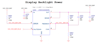

Hello All,
A few questions about my design for the LDO.
- Is the pullup on ERROR required? Can I just leave this pin floating?
- Is this LDO configured for basic functional operation?
Thank You,
Ethan

Hello Ethan,
If the Error functionality is not being used, you may leave this pin floating. Your schematic suggests that you wish to use the device in the Adjustable configuration with the help of external resistors to get VOUT = 12.5V. If so, please ensure that the OUT & SENSE pins are not connected to each other. Please also ensure that the VTAP and FEEDBACK pins are not connected to each other. This would ensure that the internal resistor network is disconnected in the device. The SENSE and VTAP pins may be left floating. The remaining part of the schematic looks fine. Thanks!
Srikanth
