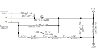

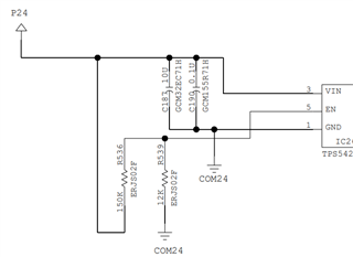

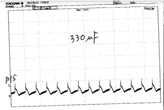

By the way, TPS54202 did not start even if I connected 120uF to the outside and turned on the power. Do you know the cause? ??
Hi Keitaro,
Could you help share your sch and capture the waveform of startup ?
BRs,
Young
Hi ,
what's the Vin-Vout and loading when start up ?
could you help capture SW+VIN+VOUT+Inductor current wavefrom for check ?
Float EN pin to check again .--remove R536 and R539
