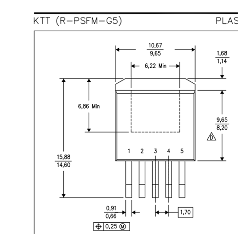

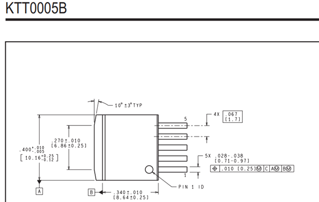

Hi team,
We received PCN.
PCN said Package Outline Difference.
In that comment, it says that shift component placement by 1.8mm towards the lead solder pad.
Looking at the board layout, I think it can be implemented without shifting as it is, is this my understanding correct?
Sincerely.
