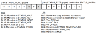

Hi Eric,
The use of first to assert Bit is when many devices are asserting SMBALERT#. This bit provides a way for the host to know which device was the first to have a problem.
Are there any other devices in your system? If yes, do you see this bit being asserted in any other devices as well? Also do you see the SMB_ALERT# (pin 15) going LOW?
The STATUS_BYTE (78h) /STATUS_WORD (79h) can tell you exactly which fault is asserting the First to Assert bit.
SMBALERT_MASK Bit can be set to avoid setting "First to Assert". But this will also mask the SMB_ALERT# (pin 15) signal.

Hi Eric,
SMB_ALERT# & hence "First to ALERT" can go low due to multiple reasons other than the output voltage:
Can you please send me the value of follwoing registers (79h) & (78h)?

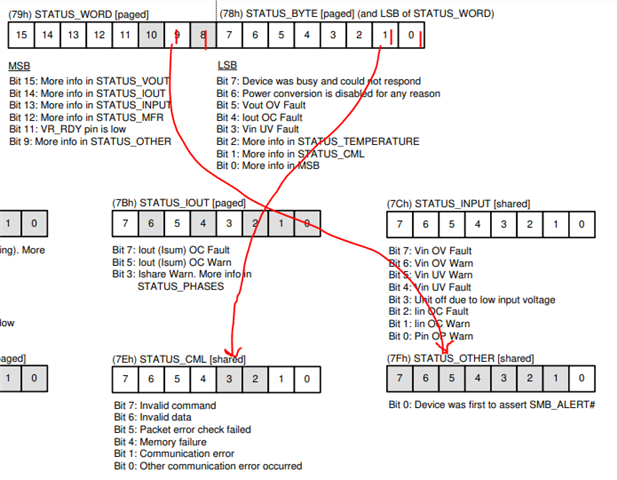

I try a couple times finally see the First to ALERT.
(79h) & (78h) was 0x03 both.

Hi Eric,
As per data from 79h & 78h, it looks like the error info is in 7Eh (STATUS_CML). Status CML has show error due to multiple reasons as listed below. But these will not cause interruption to power conversion & that's why you see Vout to be stable.
You can check the STATUS_CML register to find out the cause of error.

Hi Aishwarya,
7Eh was 0x01, from the register table has show [Other communication error occurred].
So it's seems like I can't find out the cause of error?

Hi Eric,
Other communication error can include multiple possibilities. You can check for some of the conditions mentioned in the datasheet under CML_Other.
