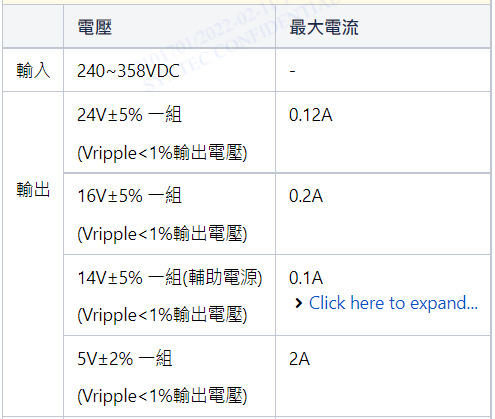

I have a customer design in UC2845AQ and have some application questions.
The customer wants to increase the switching frequency for reduce the transformer turns.
(frequency to 172kHz;RT=10kOhm CT=1nF)
And will use flyback technology
