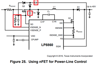

Dear TI team,
are there any suggest component values (red boxes) for the circutry needed to us a nFET for power-line control on LP8860?
Are there any impact on input voltage functional range or any other important impacts by using this solution?
Thanks for your support.
Luca
  • Hi, Luca,
    LP8860 is not recommended for new design. For new design, pls use new generation LP8864/LP8866.
    CIN: generally, 2 × 10-μF ceramic and 33 μF electrolytic, See 9.2.1.2.3 Input Capacitor Selection for details;
    Charge pump capacitor: 1-4.7uF is ok;
    SD capacitor: 1-4.7uF is ok,
    SD resistor: 1k-10k is ok.
