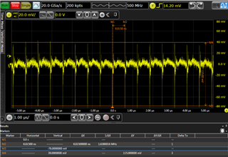

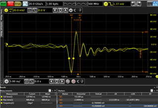

Input is 3.8V, output is 3.3V, TPS63802 is in 3-cycles buck-boost operation.
I captured output ripple with proper probe setup, using probe tip and probe ground spring as short as possible (few millimeters only). The ripple voltage is only around 20mV which is very good, however there is huge high speed noise as you can see in below screenshots:
There is noise at the input as well, but half the amplitude.
I have tried added 100nF close to pin 6 and 10 of the IC, but it did not help.
Could you please give your comments? where is this noise from and how can we reduce it? This huge noise is coupling to our RF antenna and causing bad sensitivity performance.

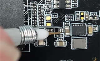

  • Hi Tao,
    Thank you for quick response.
    I did question myself that it is actually a noise or just a coupling from switching to the probe connection.
    I haven't tried using coaxial cable yet, here is how I did the probing:
    And below are some observations:
     - Noise increases with load current, as you said.
     - The output trace jumps to the other side of the PCB, and there I get noise as well, less amplitude but it is present there.
     - If I increase input voltage to 4.2V letting the IC runs in buck mode, the noise goes.
    So I am wondering what is going on. There should be some heavily switching in 3-cycles buck-boost mode, and if it is the switching noise coupling to the probe, then that noise can also coupling to other circuits nearby?
  • Hi  Pham,
    that is right, during buck mode, high di/dt loop is much far away from probe, so it will be much better.
     i think you do not need concern about this noise. the coupling  coefficient between noise source and other circuit should be very poor. it is depend on distance ,direction and area. your layout about the loop is good enough.
