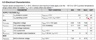

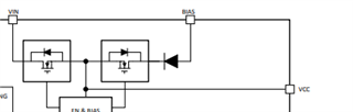

    My understanding is that the power consumption of lm5176 includes the sum of VIN and VCC power consumption. Vin can be replaced by Vbias power supply. Vin is used to drive the low-end field tube and the logic power supply inside the chip, while VCC is mainly used to drive the high-end field tube. According to which current is VIN calculated? Is it operating current according to VIN in IQ? Maximum 4mA? The current driving the field tube is ihdrv1,2 and ildrv1,2 current?Can you provide the calculation formula and parameters?Is it calculated according to the current parameters indicated by the arrow in the figure below?
  • HI Sheng,
    Vcc is used to drive the low side driver as you can see from below figure from the datasheet:
    The supply for the high side is generated by the small external charge pump (Diode / C ) on SWx and BOOTx
     Stefan

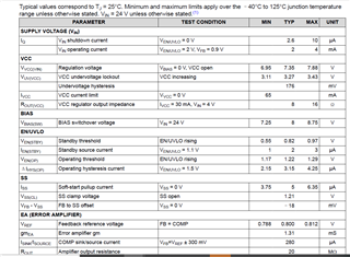

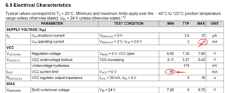

  • What is the maximum current consumed by the internal linear regulator? How to determine this?As shown in the figure below, is it 4mA or 65mA? Or how much current?
  • The above logic working current is calculated according to 4mA?If Vbias is used instead of VIN, what is the current?
  • Hi Sheng,
    the current is the same but the losses in the linear regulator will be different.
    please not that Vcc will be regulated to
    this means the the voltage on the linear regulator (Vin or Bias side) multiplied by the current will show up as losses in the device.
    So it depends on which path is used and what is the voltage level there.
     Stefan

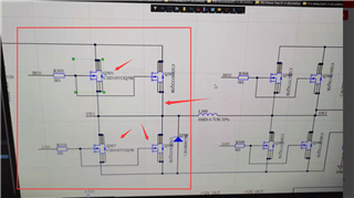

    As shown in the figure below, the power consumption of the driving part of lm5176 is calculated according to the current and resistance in the figure? P=I2R?How does the driving power consumption of lm5176 distinguish between full load and no-load output?
  • Hi Sheng,
    not sure about your question.
    The output driver for the external MOSFET does not distingue between different load conditions. It the devices adjusts the duty cycle of the gate driver signals.
     Stefan

    Is it how to calculate the power consumption of the upper and lower tube driving circuit in the figure below?

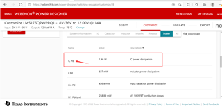

    How is PD calculated in the figure below? I use the design function of TI official website to obtain power consumption.
  • Hi Sheng,
    you can use following formulas:
    Switching Current
    =(Vin-Vdd)*Fsw*(Qg_Q1+Qg_Q2)+(RHDRV1,2pullup+RHDRV1,2pulldown)*Fsw*Qg_Q1*Vdd/(RHDRV1,2pullup+2*Rgate1+RHDRV1,2pulldown)+(RLDRV1,2pullup+RLDRV1,2pulldown)*Fsw*Qg_Q2*Vdd/(RLDRV1,2pullup+2*Rgate2+RLDRV1,2pulldown)

    Internal logic power consumption P = (vin-vcc) * IQ (4mA) calculation of lm5176? If I use Vbias as the input voltage, the internal logic power consumption P = (vbias-vcc) * IQ calculation? What is the IQ current value at this time? Note: VCC is the output voltage of the internal linear regulator.

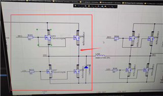

    According to my circuit design above, the switch MOS tube and freewheeling MOS tube of buck circuit use two MOS tubes in parallel respectively. When calculating power consumption, do not consider four MOS tubes?
  • Hi Sheng,
    thanks for highlighting this, on the first view I missed that, so your formula is correct.
     Stefan
