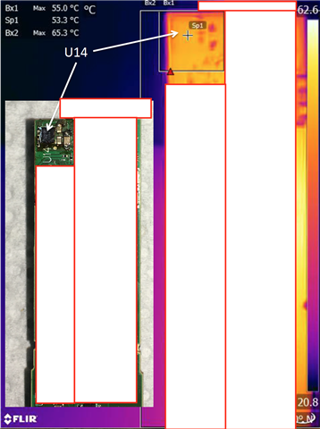

    I captured some thermal images of the switching chip U14, and also of the inductor L3 at the time VOUT becomes unstable.
    First image below shows the top side of the PCB. Image on left is visible spectrum, image on the right is FLIR thermal image. I had to blank out remaining area of PCB that is proprietary.
    SP1 points to the case temperature of U14 which is 53.3C.
    Bx1 has a red triangle that shows the location of the max temperature at 55.0C in the boxed area around U14. The box contains the input & output capacitors, and also the PCB temperature near U14.
    Bx2 is the box around the whole PCB with location of max temperature at 65.3C.
    Second image below shows the bottom side of the PCB. Image on left is visible spectrum, image on the right is FLIR thermal image.
    SP1 points to the case temperature of the inductor L3 which is 40.9C. It is directly on the opposite side of U14.
    Bx1 has a red triangle that shows the location of the max temperature at 51.7C in the boxed area around inductor L3 and also the PCB temperature in that area.
    Bx2 is the box around the whole bottom of the PCB with max temperature location at 61.2C.
    Based on these thermal images, I'm having a hard time believing the junction temperature of U14 is at 140C. Given we have seen this problem on multiple PCBs we believe we have a bad batch of parts.
    We plan on sending this PCBA to get U14 replaced, but need to understand what is happening to prevent possible problems in the future.
    Tony
