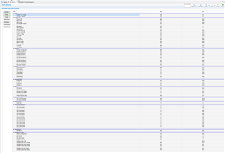

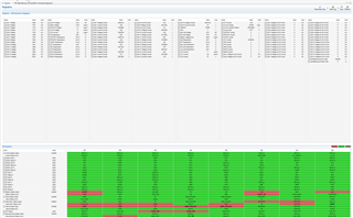

Using bqStudio, I import the default settings, then set the bit to enable REG0, and set the bits to enable REG1 for 3.3V. I can see REG1 turn on, 3.3V as expected. REGIN is ~5.5V as expected.
However, I'm seeing about ~22mA flowing into REGIN (measured at the resistor that is in series with the NPN). At first I thought it was REG1 getting loaded down by something, so as a test I disabled REG1 and enabled REG2 instead (to make sure REG0 is enabled).
With REG1 disabled and REG2 enabled, I see REGIN=5.5V, REG1=0.0V, REG2=1.8V (which is what I set it to), but I still have that ~22mA flowing into REGIN.  Since REG2 isn't connected to anything else, that current has to be going somewhere in the chip.
The voltage at BAT is higher than REGIN, so it's not that diode that the datasheet makes reference to.
Can you think of any reason there would be ~22mA flowing into REGIN?
Here are screenshots of the registers and data memory, in case that's any help:

    The REGIN current should be equal to the current on the REG1 and REG2 outputs. Can you share your REGIN circuit and show how you are measuring the 22mA?
    Are you observing the same thing on the EVM?
    Matt
