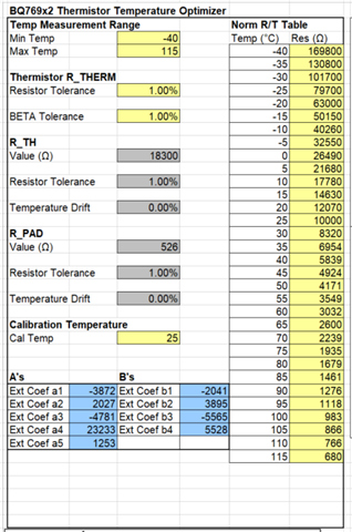

Before using the BQ76952, we encountered inaccurate temperature acquisition, and the calibration coefficient calculated by the official calibration tool is still inaccurate. I asked you in the forum to use the new tool to recalculate the calibration coefficient and the temperature is normal. Now we have changed it again. The model of the thermistor is TH11-3H103F-RT, and the R/T meter is attached. Can you help me calculate the calibration coefficient of this model? Or give us your latest tools for calculation.
