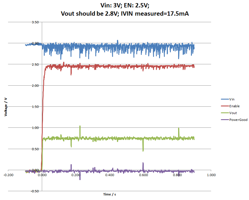

  • I performed the measurement with a third prototype and managed to not destroy the regulator by keeping the input voltage at 3V. The regulator draws about 17.5 mA. I only switch it on for one second to avoid permanent damage. The output voltage is around 0.75 V which look suspiciously like a diode voltage. However I de-soldered all external diodes of this circuit (including the Zener diodes) without luck:
    The reason for the noise is a sub-par GND connection to the oscilloscope, It should have no significant impact.

  • Hi Marius,
    I do not see an obvious issue with the design. I would check the input supply behavior when current limit is hit. During startup, the converter current demand will be much higher and how the supply reacts to the current limiting may cause a problem.
    To save another IC, you can test just the input supply leads across a fixed resistor (maybe 100 Ohm) and to measure the supply and current as you increase Vin. There might be some voltage spike when it hits current limit. Alternatively, you can have try holding EN low while you ramp up VIN. Then, take EN high (after the caps are charged and UVLO is exceeded). You can also try replacing the supply which has higher current limit to see if that starts up the design.
    Amod
  • Thank you every one for your support and suggestions. I finally found the error after dissembling the entire circuit piece by piece:
    It was just an assembly error: the Inductor was rotated by 90 degree on all boards
    Because of its DC resistance of 0.03 Ohm this was difficult to spot.
    Sorry for taking up your time with such an obvious error. We have to have a serious talk to our EMS Partner.
