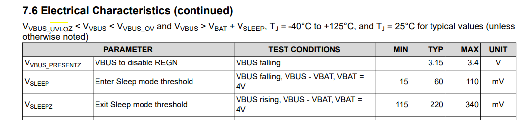

    Do I understand correctly, that the UVLO comperator only detects UVLOZ for a VBUS rising edge. A falling edge on VBUS does not affect the REGN LDO?
    Ambroise
  • Hi Ambroise,
    Section 7.6 of the datasheet states that if VBUS falls too low (TYP 3.15 V) the REGN LDO will turn off.
    Garrett

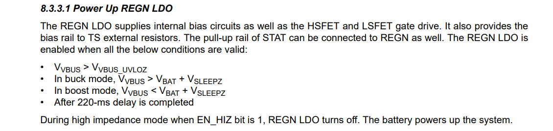

  • Hello Garrett,
    Thank you for your response, that leads us to the original question:
    If REGN is going to be off when there is no USB power, then how can the system decide shut the Booster off at elevated temperatures?
    Ambroise
  • Hi Ambroise,
    When in boost mode the device, including REGN, is powered by the battery voltage. For example, when boost mode enable conditions are valid removing input power transitions the device between charge mode and boost mode. REGN will not shut off.
    My response above in regards to the REGN LDO turning off when VBUS falls too low is for the scenario when boost mode is disabled.
