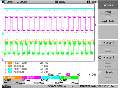

This led us to placing a 0.5Ohm resistor in the positive or negative battery terminal paths to the PMIC.  Every time we observed, the unit going into battery detect mode and the charging current varying from 0-XmA every 25ms. See plot below.

PMIC out [pink signal] it varies between 3.8V and 4.2V every 25mS
Charge Indicator [Blue Signal) high impedance
Power Good [Orange Signal] Low, power is good
Charging Current [Green Signal], it is varying every 25 mS

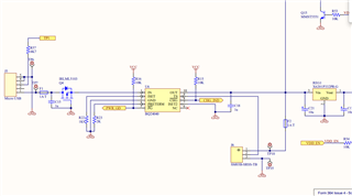

    2. Would you be able to send over a schematic so we can get more info on what may be causing this behavior in the returned units?

    2. Here is the schematic

    I have placed a 2.2uF cap and it doesn't fix it. I have seen that sometimes for the issue to be seen, I need to place a 0.5Ohm resistor on both the  battery positive path and the TS paths at the same time. In the battery detect flow diagram below, if the battery isn't present, does the PMIC OUT pin go to 4.2V and it fails the decision 'is vout < vreg - 100mV' and continues then into the next part of battery detect mode.

    Battery detect mode can be entered from removing the thermistor, pulling the TS terminal up to TTDM threshold, or by removing the battery. I believe the issue here is that the increased resistance on both BAT+ and TS is causing the IC to enter TTDM and thus starting battery detect mode. One way to avoid this issue would be to add a 237k resistor between Ts and VSS to disable this functionality all together.
