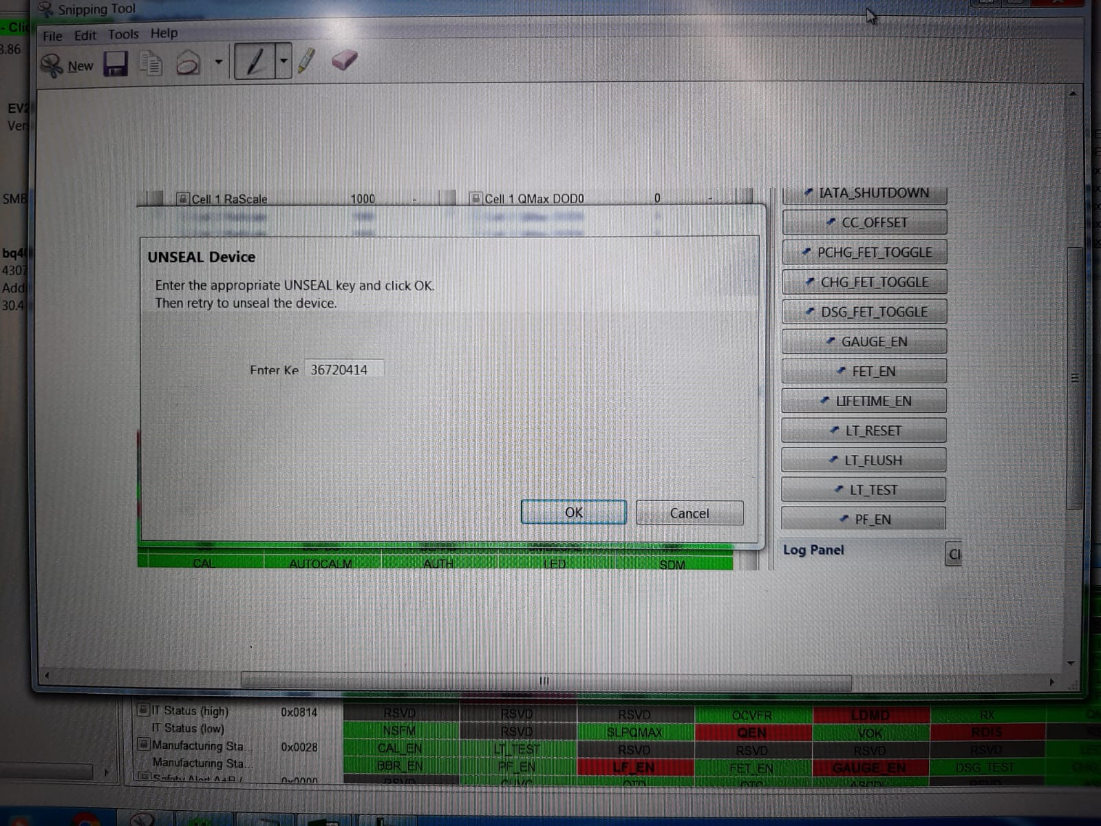

    But when customer press the unseal button it demands the key as attached picture.
    He need that key to unseal the battery IC BQ34Z100-G1 .

  • Hello Gerald,
    The default keys are used by default in bqStudio. The popup is shown only if the default keys did not work.
    The keys were changed by customer. The customer keys will need to be used. There is no way to unseal without knowing the key that was programmed. If customer, does not remember the key, then use a new IC and make sure to note down the key when it is changed from default
