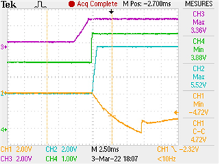

1 - On the following picture there is a spike on VNEG output which is not observed in the datasheet. What can be the cause?
2 - When the device is powered off and powered-on before VREG reach 0V then VNEG does not start correctly and then stays incorrect (about 1.86V which is outside the specified range).
Is it expected that VREG remaining voltage level impacts VNEG startup? Please note that VPOS is correct.

    I reviewed the schematics and it looks good. I suspect that the transient in the first scope plot could be due to spike in load current beyond 40mA.Also, I would not expect residual voltage on the VNEG rail to cause the startup problem shown in the second scope plot in your post. I suspect this also to some artifact of the load current at startup. Can you please remove the load from the board and see if the anomalous behavior goes away? i.e. measure the same scope plots but without the load attached.

    Just to complete my previous message. TPS65132 -5.4V VNEG power rail is intended to power a -5.0V LDO to supply analog components. 10µF is set on -5.0V LDO output (same as the one mentioned on the schematic above (C20)). Power consumption on VNEG -5.4V is 15mA once the system is running. I don’t know what is the peak value during startup condition.
    First test was to remove the load as you suggested (-5.4V VNEG not connected to -5.0V LDO). There is no spike, TPS65132 works as expected.
    Second step was to connect -5.4V VNEG to -5.0V LDO input. 10µF on -5.0V LDO output is removed. Spike is still here but smaller than our default configuration.

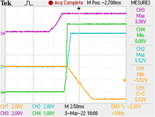

     Purple: Vin, Green: VREG, Blue: TPS 65132 5.4V output, yellow: TPS 65132 -5.4V output
    In this configuration we still can observe an incorrect value on TPS 65132 -5.4V output. Picture below shows an incorrect TPS 65132 -5.4V output while there is 3.88V on VREG. Previous picture shows a correct TPS 65132 -5.4V output while there is 0V on VREG. Perhaps it is a coincidence but further to our tests it is reproductible.
    Purple: Vin, Green: VREG, Blue: TPS 65132 5.4V output, yellow: TPS 65132 -5.4V output.

    Since TPS65132 works as expected when load is disconnected, I strongly suspect that load current is much higher during start up than the nominal 15mA during normal operation and that is what is causing the spike and anomalous behavior on the VNEG rail. The fact that removing the 10uF at the output of LDO reduced the spike also points to the same logic of higher load current during startup because the LDO was charging the 10uF capacitor during startup when it was there. So this all makes sense. You will somehow need to reduce the load current on VNEG during startup of your system for it to work.
