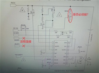

Reference TI's EVM board to make a circuit diagram to measure the charge (nominal 14.4 V, capacity 10 AH) of a four-string battery, as shown in the following figure:
Q1: Do the RLEN and MOS pins which are connected to the LEN have to be connected? Are they required to configure the associated registers?
Q2: The configuration is as follows:
CAL_EN high, Flash update OK Voltage set to 100 mV, VEN_EN high, number of series cells set to 4, Temp configured to 0 (with internal temperature sensor), Voltage videder set to 24500, Design Capacity set to 10000mAH, Design Voltage set to 3600mV, And finally RESET. Voltage, current, temperature, and power are available, and then the voltage temperature and current are calibrated.
Are there any missing steps or missing configuration of parameters other than GPCCEDV?
Could you help check this case? Thanks.
