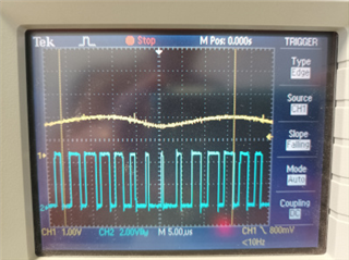

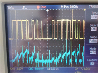

    Here is a screenshot of gate/RS:
    As I begin to understand how it works, it seems that duty cycle isn't stable, and is too high, so current sense limit is overflowed. Could it be a layout problem, or any filtering not enough ?
    Regards.
  • The last screen was with Rs=6.67ohm.
  • Hi David,
    now that the over current is not triggered anymore we can see that the duty cycle is not stable.
    See that short and long pulses on the Gate.
    This indicates that the slope compensation is not high enough.
    So for the 6.67 mOhm sense resistor can you please try to  replace R508 with ~ 700 Ohm.
    When going back to the 10mOhm it should be in the range of 1.7kOhm
    See also datasheet section: 9.3.7 Current Sense and Slope Compensation (CS Pin)
     Stefan

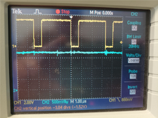

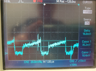

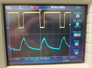

  • I've replaced R508 by a 820 ohms, and it's not really better... Probed P21G and CS pin directly:
  • Hi Olivier,
    the signal on the CS pin is really very noisy - may you can try to enable the bandwidth filter on the scope for this channel.
    Nevertheless if the Slope compensation does not improve the heavy jitter on the switch node signal, some other problem needs to be in the system.
    Maybe you can share the layout, iI really would like to ensure that this is not related to something in the layout.
     Stefan

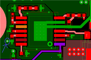

  • I had a look at my layout, and I think I found where the problem is, can you confirm me :
    I have put in blue on the bottom-left of the layout, there is a VIA which connects the local analog ground which is in L8 (bottom) and L7 to the digital GND. This via shouldn't exists here.
    Could it be the problem ? If you think yes, I will try to remove it (very delicate operation).
  • Hi Olivier,
    you are right this really can trigger the issues esp. as next to this the great GND connection. This means a lot of current the be flowing in the ground plane and disturbing this node/via. I definitely would give it a try.
    Once we have the system basically stable then let us try to tune the system for better stability with the Rs, Rsl, Rf, Cf.

    I took new screenshots, can you really check my layout, check my values, and give me steps to find the issue ?
    As my design is very little, I've took different screenshots separately, with COMP pin as the common signal CH1 between each, and CH2 with BW limited.
    Conditions : Vout~9V, R_load~12 ohms, R505=5mohm, R509=820ohm, the rest hasn't changed.
    CH2=Vin (P5V) => 200mV peak-to-peak for input voltage ripple.
    CH2 = Vout (P_SRC) => ~600mV peak-to-peak for output voltage ripple.
    CH2 = Gate (P21G)
    CH2 = P21D
    CH2 = CS at pin 7
    I hope you'll find the problem very quickly.
    Best regards.
    Olivier.
  • Hi Olivier,
    with this setup you have almost no phase margin.
    Can you replace
    R558 : 1.7kOhm
    C445: 68nF
    and probe again. (output ripple should be in the range of 20mV)
    If this would be OK the test with Vout= 12 and Vout=20V
     Stefan

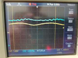

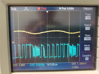

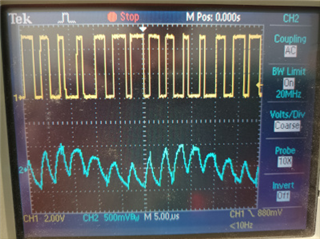

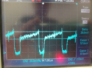

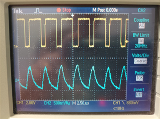

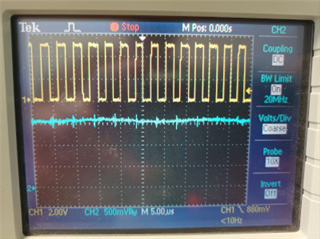

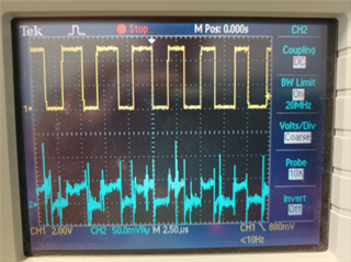

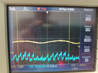

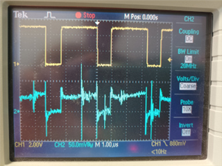

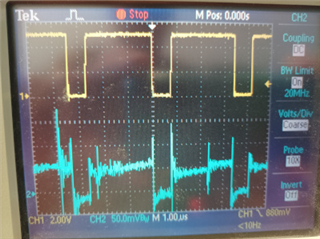

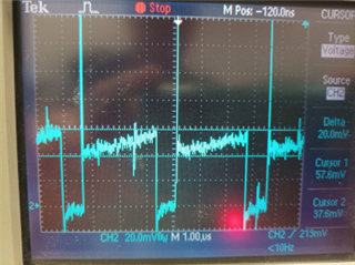

  • Here are the new measurments. CH1 = GATE on each plot.
    20V-12ohm (6.8ohm doesn't work):
    CH2=Vout in AC:
    CH2=COMP
    CH2=CS
    15V-6.8ohm:
    CH2=Vout in AC:
    CH2=COMP:
    CH2=CS:
    9V-3.5ohm:
    CH2=Vout in AC:
    CH2=COMP:
    CH2=CS:
  • Hi Olivier,

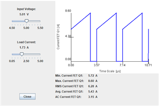

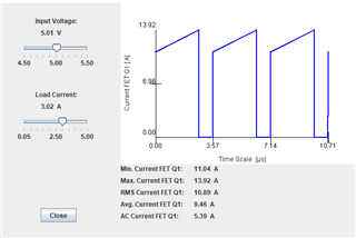

    can you try to replace the 100uF with 50uF - the AC current of 5.6 A is quite high for an capacitor.
    (you can also take 2 x 100uF if you have then available)
    Can you please also share the part number of the used capacitor - if this is a MLCC i would like to check the DC bias.
    With 9V: the first picture shows a not stable gate clock, while the others are OK. Can you check this again?
     Stefan
  • C441 is a chimik SMT, 865080545012 from WURTH. C440 is a MLCC standard ceramic 10uF 10% 35V X6S CR0805.
    I suppose the problem comes from C441. If yes, can you tell me the specifications to follow for that ?
    For 9V, it is stable if I draw less output current, but when I approach to the maximum current, it is worse. 20V-3A is not stable at all.
  • Hi Olivier,
    the 865080545012  is a Aluminium Electrolytic Capacitors with a relative high ESR of ~ 370mOhm.
    With a Capacitor RMS current of ~5.6A  (@ 20V/3A output) this give the seen voltage drop/voltage ripple on the output.
    (Where the 10uF compensate the higher peak)
    Please try to use an output cap with lower ESR e.g. 875115652007
    But as you have a quite high RMS current for this capacitor I recommend to replace this by 2 or 3 capacitors in parallel to split the ripple current to several capacitors, otherwise it might be overheated.
     Stefan

    20V-1.65A: OK, ripple is ~270mVpp @ 290Khz. D~75%, comp is flat (see image).
    It seems I can’t go over ~45W.

  • Sorry....
    Here it is:
    From the description above i would assume this picture should show :
    "comp is flat (see image)"
    with Vin 5V/ Vout 20V /1.65A ?
    For me this looks like the signal on CS.
     Stefan
  • When assuming this is the voltage on the current sense pin this would exactly match to a load current of 3A with Vin 5V and Vout 20V
     Stefan
  • Hi Stefan,
    OK, the forum works again for me.
    Yes, it was the pin1, and I've just verify it again, Vin is still 5V, and Vout is 20V (20.6V), the load is 12 ohms, it can't be 3A load current (it is a true power resistor, I've checked it's value). Rs is 5mohm-1W, I've changed it to have a true 5mohm.
    Where is the problem ?
  • Hi David,
    yes, the forum was down for a few minutes, I had the same issue.
    Can you help me to understand - which pin 1 - pin 1 on LM5156 is BIAS.
    I am really confused on the currents if the waveform is on CS: do you have a chance to measure the input current for this power stage. (Measurement with a multimeter would be OK.
    20.6V^2 / 12 Ohm => P out 35.36 W  -> 90% efficiency P in = 38.9 W  -> I_in (5V) = 7.78 A
    As mentioned the waveform looks like the current for 3 A output
    with 5mOhm this is
    V(cs - max) = 70mV
    V(cs - min) = 55mV
    With 12Ohm load -> 1.72A this would give:
    with 5mOhm this is
    V(cs - max) = 43mV
    V(cs - min) = 29mV
    Note: this pictures are made with Power Stage designer.
     Stefan
  • Yes, sorry, it is pin 7, CS.
    I won't be able to measure Input current on my board, too difficult. Could I do any other indirect measures ?
  • I have verified the voltage on R505, it is the same as pin 7 :
    If I change output voltage to 15V, on the same 12ohm load, it does like that:
  • Hi Olivier,
    can you make a delta measurement of the supply current of the complete application with EN_PRSC1  (Enable on LM5156).
    Maybe you can control this signal.
    The delta in the current should then show the calculated value.
     Stefan
