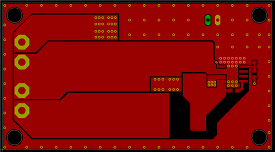

    Thanks for your input on this!  The TPD5450 circuit will be just one of 5 circuits sharing the same PCB (including 2 other switcher circuits and a microprocessor). I ended up leaving the top layer GND copper (for the in/out caps and diode) isolated from the rest of the ground copper except at the TPD5450's GND pin. I also left the input and output GND connection points isolated from the other layers too (as is done in the EVM).
    But, I expanded the copper from the underside of the TPS5450 a lot and realized that since that top copper would be so well tied to the other copper layers because of the thermal vias, I could connect it to the rest of the top copper layer. The image below shows the PowerPad copper expanded but not connected to the GND copper I have around the outside of the board.

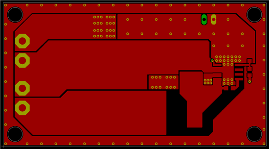

    This next image shows the PowerPad copper joined to the other top layer GND copper. Ignore the number of vias I have for now.
    I kind of like the idea of keeping the heavier switching current flow in the top layer central GND plane, isolated from all the other GND layers except at the GND pn and PowerPad connection point. Don't know if this is a good idea or not though. :-)
    A small board run is being done to test the circuit in several prototypes along with the other circuits. Eventually, the TPS5450 circuit would be lifted almost as-is and dropped onto the larger board. The peripheral GND vias would not be so numerous and GND would be delivered to this circuit via a bunch of vias to the other GND layers replacing the two GND center connection points on the left. This, I thought, would keep the heavier switching currents on the top layer, isolated and away from the main GND layers, but still allow for low-impedance flow between the TPS5450 circuit's components.
    At least, that's the idea. If you feel this approach might be a problem, please let me know. A couple more images to explain the circuit follow below. The circuit is laid out follwoing the EVM as an example. C7 and C8 in the upper left are bulk caps since the power is located up to several inches away from the board. D2 is a TVS diode for some ESD protection as the prototype output connections will be handled a lot. I'll be swapping positions of D2 and C10.

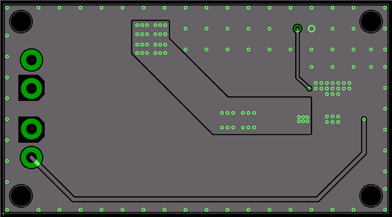

    The image below is layer 3. The other two layers are solid GND copper but leaving the two GND connections isolated as is also done on this layer..
