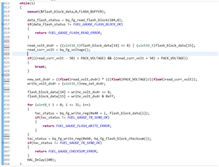

  • Hi Shirish,
    I have followed the same fashion for the calibration that mentioned in document link www.ti.com/.../slua665.pdf. the only difference is i tried to calibrate till fuel gauge return the +/- 50 mV voltage of applied voltage(57600mV). i have attached the code snapshot. still not update
    and i used same method for current calibration.
    PACK_CURRENT = -5000mA
    cc_gain = ((uint32_t)flash_block_data[0])<<24 | ((uint32_t)flash_block_data[1])<<16 | ((uint32_t)flash_block_data[2])<<8 | (uint32_t)flash_block_data[3];
    gain_resistence = 4.768 / xemicsToFloat(cc_gain);
    cc_gain_delta = ((uint32_t)flash_block_data[4]) << 24 | ((uint32_t)flash_block_data[5]) << 16 | ((uint32_t)flash_block_data[6]) << 8 | (uint32_t)flash_block_data[7];
    delta_resistance = (5677445.6/xemicsToFloat(cc_gain));
    read_curr = bq_fg_current();
    new_gain = (((float)read_curr)/((float)PACK_CURRENT)) * gain_resistence;

  • Hello Diwakar,
    It is very time consuming to debug someone else's code, especially when we do not know details of the system it is running on.
    If you need to program the srec, then i recommend that you use bqStudio. This is not required in production because the srec is pre-programmed on the bq34z100-G1.
    For production I recommend that you use bqProduction if you have issues with your own code. To debug your code, the best way is to try the same sequence from bqStudio. If bqStudio works and your code does not, then the problem would be in your code. If bqStudio also does not work, then the problem is some setting or hardware/input related.
