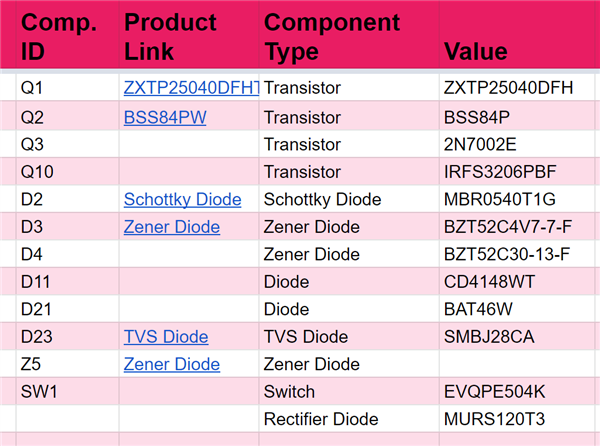

Also, the table below is a list of obsolete/unavailable components (the component numbers refer to the circuit diagram in the linked datasheet). Are there any recommended alternatives to replace these components?

    You can look up the obsolete parts online and search for similar parts from there. You may also see our EVM BOM for more guidance.
