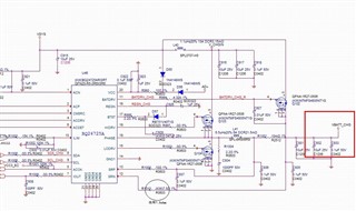

We use thte BQ24725A for the battery charger, and there are 3 cell lithium battery series,
Now the output voltage of the Vbatt_chg isn't 12.6V if there are no battery connect or the battery capacity is zern,
The schematic diagram as the attach, please kindly advise why the output voltage is abnormal for the Vbatt_chg

    We have the below issue for this chip:
    1. We can charger the battery if the battery voltage is higher than 8V when power on, and the chager voltage(Vbatt_chg) is 12.6V;
    2. We can not chager the battery if the battery voltage is lower than 8V when power on, and the chager voltage is 0V;
    3. We remove the battery, and enable the EC, the charger voltage is 0V;
    So we have no idea the above issue and please help to analyse, we can provide the detail file if your need, thanks.

    There is something I noticed about the statements you made.
    VBATT_CHG will never be 0V even if the battery voltage is lower than 8V. VBATT_CHG is only determined by battery voltage. If there is a battery there, it will never be 0V.
    The fact that you see 0V at VBATT_CHG indicates to me that it is an issue potentially with your gauge/protector/monitor. You may have triggered some protection on your battery pack and the pack opened. Recommend checking that aspect.
    I would also recommend getting an EVM and ensure both the EVM and your design operate the same under a certain test condition.

    And we have the other situation: we don't connect the battery, and enable the EC, but the VBATT_CHG is still 0V output, so please advise if there are any error, thanks.
  • Hi Zhang,
    If you enable charge and there is no battery there, the charger will treat the caps as battery and charge it to regulation voltage (set by 0x15).
    The normal behavior should be the following:
    1. Battery exists. Enable charge -> voltage dominated by battery
    2. Battery does not exist. Enable charge -> voltage goes up to regulation voltage set by 0x15 because the charger charged the caps.
    If your case 1 is working, then your case 2 should work as well. If your case 1 is not working, then the direction to debug is different.
