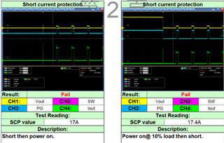

Hi Expert,
Customer to test OCP & SCP for TPS22990 device, the waveform as below:
I didn't see any protect function on DS, could you help to know if no any projection, why we saw output retry as below test result?
OCP:
SCP:

Hello Mark,
Can you describe both of your test setups and if you are using the EVM? If not using the EVM can you send the schematic just involving TPS22990? Also, is the ON signal tied to Vin or does it have its own supply?
