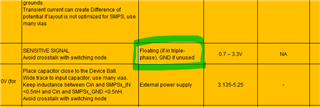

  • Hello Alex-san,
    I'm sorry for my late reply.
    I checked Design checklist excel file and SMPS7 feedback pin connection (if not used) is described as in below
    Floating (if in triple-phase), GND if unused.
    I'm confused which is better.

  • Ryo,
    If the pin is not used, then floating the pin or grounding the pin is acceptable. If the device is in triple-phase we do not want this pin to be forced to GND as the device will need to bias it at some point. If, however, it is know that SMPS457 will never be used in triple-phase during any part of the device's lifetime, it is OK to force it to GND. That being said, even if the pin is left floating and SMPS457 is never used in triple-phase, there is no danger to the device as this is also a perfectly acceptable configuration.
