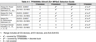

We have planned to use TPS65086x device for Xilinx FPGA board power mangement.  We have followwing current requirements at different output of TPS65086x :
O/P Power net   Voltage Current required(A)
BUCK1 3.3 5
BUCK2 0.85 5
BUCK3 1.2 3
BUCK4 0.9 3
BUCK5 1.8 3
BUCK6 1.2 5
LDOA1 2.5 0.2
LDOA2 1.5 0.6
LDOA3 1.2 0.6
SWA1 3.3 1
SWB1 1.8 1
SWB2 1.8 1
With the help of above table could you suggest us that we should select TPS6508640 or TPS650681?
The power sequencing requirement is as follows : BUCK4-> BUCK5->BUCK3->BUCK2->SWB1->SWB2->SWA1->BUCK6->LOAD1, rests at any point.
