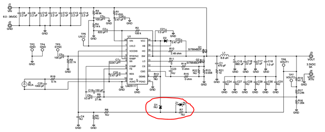

Hi team,
what's the purpose of these two diodes, and why is it connect to VCC?
Ho Andy,
How about the diode function between VCC and HB pin , is it necessary?
And what's the spec need for this diode?
Hi Fred,
Do you mean diode D2?
This is essential to block the high voltage when high side switch turn on, SW will equal to VIN, HB pin voltage is VIN+VCC
B R
Andy

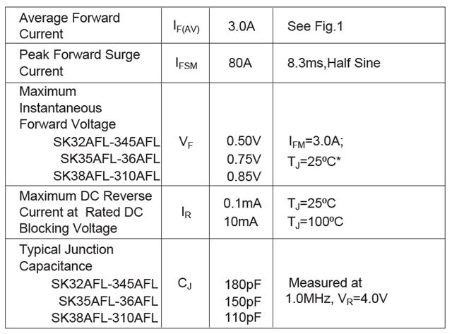

Hi
is there a limit or spec for this bootstrap diode since I heard large junction cap may lead to large reverse recovery

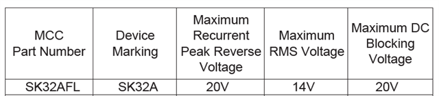

would you evaluate below is suitable or not?
Hi Fred,
Do you mean the D2 Bootstrap diode?
Voltage rating: >1.2*(Vin_max+VCC)
Current rating: average>50mA--100mA, peak 1A~2A
SK32 is too big for D2.
B R
Andy
Hi Andy,
I mean D2.
1. If Vin=24V, (24+7.6)x1.2=40V , does this mean SK32 can't afford 40V?
and why is equation related to Vin, I though it connect only to VCC
2. by too big ,do you mean average current rating of diode?
Hi Fred,
D2 20V rating is not enough as I already explained in the thread:
1A rating is enough for D2, the package size should be as smaller as possible to reduce the loop area.
B R
Andy
Hi Andy,
1. 1.2 in the equation is for margin, right?
2. is loop area related to junction cap? are they same
1. Yes, it require 1.2X or higher margin
2. junction cap is not critical for bootstrap diode
