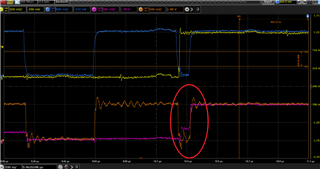

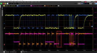

The following pictures shows the waveform in step5. The upper two signals in the screen are on hub host side, and lower two are hub local side(which are connected to PMIC and let's just focus on these two).
There is no ACK on I3C, and we found a very strange "step" on the data signal in the red circle in the scope screen capture.
The following is a zoom-in view on the circle.

    After a bus reset, the R34[3:1] is set 111b based on JEDEC spec. but the captured waveform has address 0xFC(1111 1100b -> 111 1100b) which did not match the 111b defined by the R34[3:1].  Please compare this with a good I3C reading waveform to see whether the address is right. if address is not right, NO ACK is what expected.

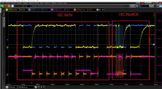

    Q2: SCL is driven to low voltage for ~100ms during reset, please refer to the following scope screen capture.
    Q3. In step5, 0x7e is sent in 1MHz speed, which followed by I3C mode read on slave_address=0x48, reg_address=0x32. The lower two signal in the picture are for local side probe.
    The following is the zoom-in view on I3C operation.

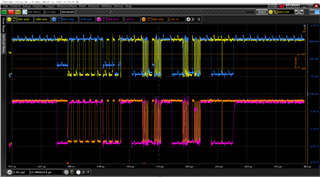

    We also captured the waveform on IDT devices which works as expected. Totally the same opration as above, and we can see ACK and read-back data transmition in the below scope screen scope.
