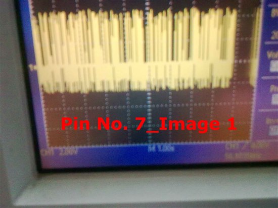

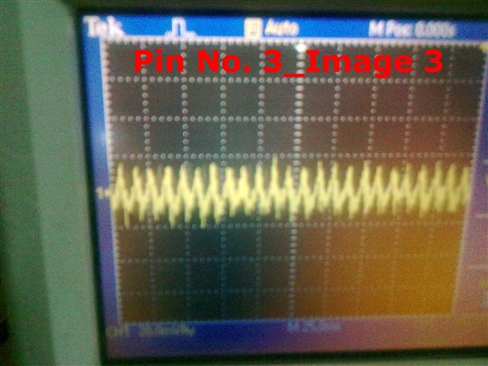

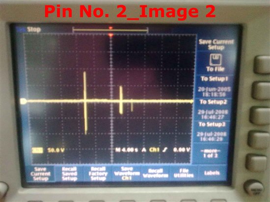

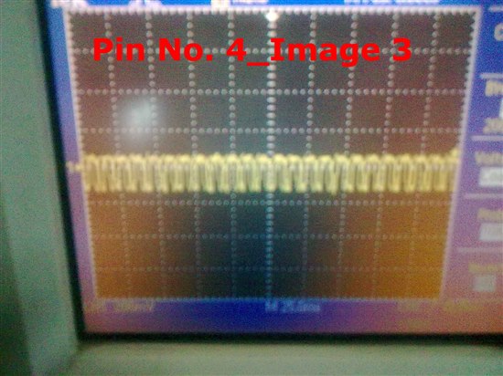

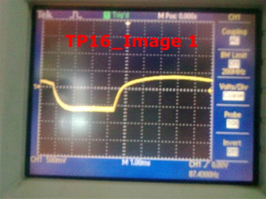

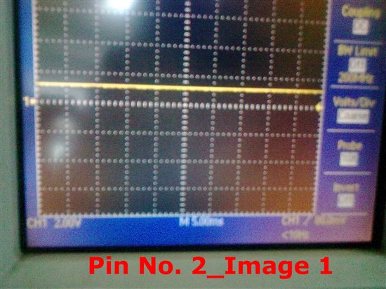

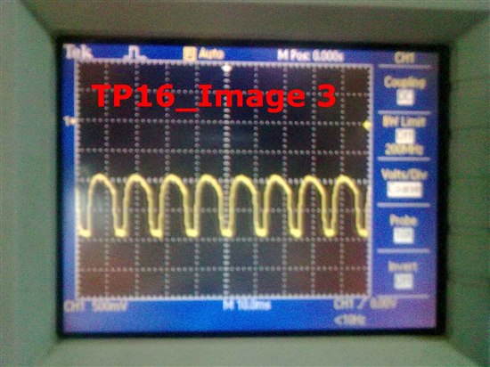

  • The schematic is identical to figure 15 in the datasheet and so should be okay.  I cannot see the inductor part number but I see that it is in a 1210 package?  Such a small packaged, 10uH inductor having a 1.5A current rating is rare.  What is the inductor part number? Can you send some measurements, such as the voltage at pin 2 and 3 and a scope shot pin 7, pin 8 and TP16?

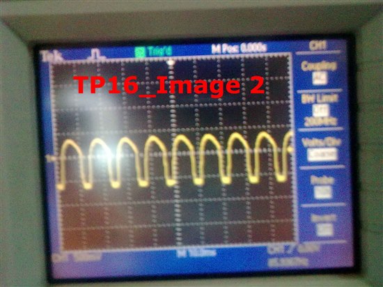

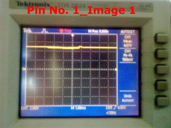

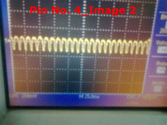

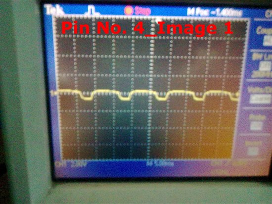

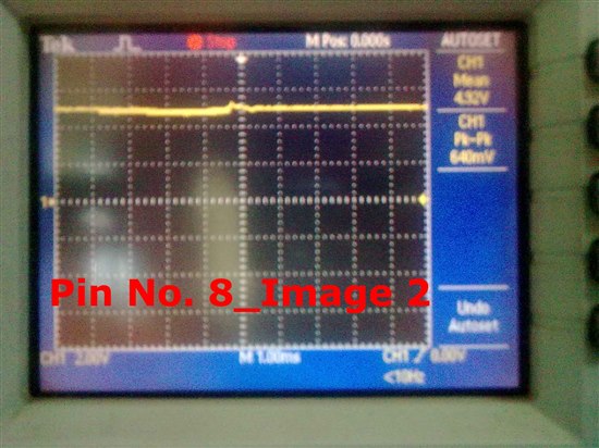

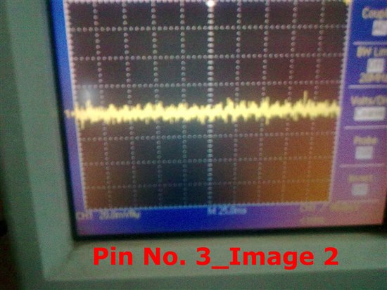

    Also the scope shots are given below
    So these are the Scope Shots for various pins. Also at TP16 we are getting only -1.24V output voltage instead of -5V. Kindly revert back ASAP.

  • Yes, the output must be connected to the anode of the diode.  Make sure the diode is installed with the correct polarity.

    Could you please post your board layout?  There is a lot of noise on your SS pin and it is at a low level.  This will cause the IC to not start.  Possibly noise is coupling into this pin from an adjacent noise source or poor grounding.  You can also remove R1 and R2 and retest.

  • Without the inductor, there should be no output.  The inductor and diode need to be present for the circuit to regulate and the FB pin needs to be connected to the output voltage.  Other configurations will not work.
    Since your circuit is the same as the schematic in the datasheet, the only possibility is layout or test setup.  The circuits in the datasheet have been tested and do work.  So, I believe the next thing to check is your layout.  You can order the EVM and evaluate it or post your layout.
