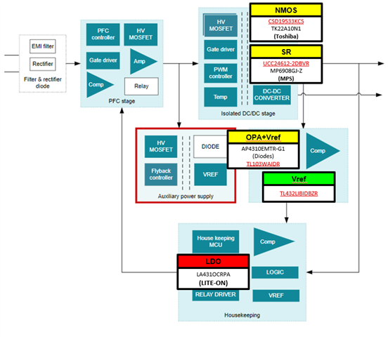

Could you suggest me the TI solution which has pin-pin of LA431OCRPA (from LITE-ON).
Dear Team,
The best alternatives are TL431BQDBZR or TL431LIBQDBZR.
