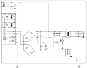

I have a PD SMPS design which uses the TPS23751 to power my application.

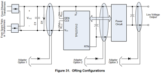

In addition to the PoE supply, i provide a DC input which is connected according Option 2 Oring (see datahseet Page 31 Figure 31).
Protection of the PD manager is based on SLUA736 for 2kV with additional 56V TVS diodes in parallel to the HOTSWAP-FET.
I do have a massive Surge problem.
For the Test, the device is DC input powered with 24V
Ethernet is connected. PoE is not provided.
surge is applied common mode referred to PE. Only currents through the pim/sec capacitors (3nF) occur and with a rather low value (up to 3A)
While applying already a 500V surge pulse (1,2µs / 50µs) the PD manager switches off and remains off.

As the PoE Block diagram notes, that al voltages (incl. PoE UVLO) are referred to V.SS i would assume, that a small capacitor between V.SS and RTN might be an option, but i am not sure if this is possible with respect to the IEEE802.3
btw.: It is an 8 Layer design with massive GND plane underneath the PD-Mgr. VB and VC are buffered with 1µF ceramic caps directly beside their corresponding pins.

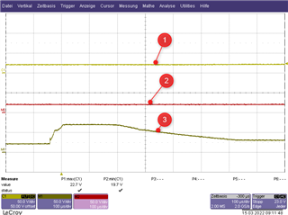

    Means, we supply our device via the 24V DC input. In addition, network (without PoE) is provided via the CDN for HV-decoupling. Unfortunately, this CDN adds a significant capacitance to PE
    The following screenshot shows the Voltage between VDD and VSS of the TPS23751.
    (1) with no ethernet cable connected
    (2) with 10m SFTP cable connected
    (3) with the CDN connected via 0,3m UTP cable
    So, for the moment I am not sure if our CDN is allowed to be used in this setup but on the other hand, capacitances from a PoE Line to PE can occur. I can not estimate if this is a real life scenario as i can not find any statement in the IEEE how big the parasitic capacitance on a PoE Line to PE is allowed to be.
    As not every surge leads the PD manager to latch in off state, I assume that the surge is somehow interpreted as PSE negotiation and erroneously triggers the PD PoE Statemachine which resides in UVLO after finishing the surge.

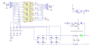

    1. Would it be possible to put a blocking diode on VDD --- there is one for the adapter, but can we add one for VDD_VSS? Does that make sense? Put it before the input inductor.

    1) Adding a blocking diode on VDD would not work i guess. I cant think of an position for the diode where on the one hand PoE and DC input are still possible and on the other Hand the surge is kept away from the VDD-VSS input.

    1. When I look at the provided scope shot, to me trace #3 shows a voltage on VDD_VSS which makes me conclude the surge is affecting this input. How do you understand that image?
    For the diode, would the below image not work? This would block current flowing this way, and the TVS on the VSS_RTN would block current flowing the other way. Might require a layout change.
    Yes, i would also say so. I am pretty sure, that the effect is triggered due to a voltage between VSS and VDD. The above screenshot is made with the CDN connected. With 50m cable connected, the is only a spike left but this seems to be enough.
    I will try that on Monday but i can't see that the diode should have an effect on the problem, as it is in the same direction like the diodes in the rectifier bridges. I will see on Monday.

    The link provided here is all of our guidance on surge protection for the PD: https://www.ti.com/lit/an/slua736/slua736.pdf?ts=1648048799201&ref_url=https%253A%252F%252Fwww.google.com%252F
    Figure 5 and Table 4 give a proposed schematic and part recommendations up to 4kV surge protection. Can you try implementing these components?

  • Figure 5 and Table 4 give a proposed schematic and part recommendations up to 4kV surge protection. Can you try implementing these components?
    In our Board...
    - SPD1 is applied with a SMCJ58A TVS Diode
    - SPD2...5 is applied with a Sidactor array (SEP0640Q38CB + P45CM) providing  a 500V protection against PE (i did not draw that in my above drawing, as it makes no difference if this components are populated or not.
    - "clamp" on the data lines are SP2555NUTG
    -> compared to figure 5 we do not have any further options.
    The voltage spike that occurs on VDD/VSS/RTN is limited by the TVS to approx 70V. that is enough to misstrigger the PoE UVLO.
