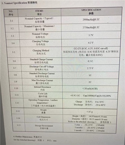

  • Hi Expert,
    The battery parameter is as below. The cell number is one cell.  Please kindly advise suitable charger IC and protect IC. Also if the discharger protect or other circuit, please tell me as well. Could you please recommend two sets of solutions, one is automotive and the other one is non-automotive?
    Thanks a lot for your help!

  • Hi Expert,
    Add the pic. Thanks!

  • Hi Eric,
    In power bank applications we often see customers using the OTG feature present in switching chargers such as BQ25619 or BQ25895.
    There is also BQ24105-Q1 for an automotive switching charger.
    For protector we have BQ2970 or BQ2980.
