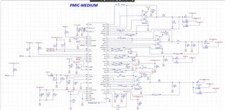

    Could you please share you schematic along with the OTP generator that has the custom settings programmed on the PMIC?
    Schematics:

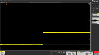

    Could you share a capture of the power-up sequence (after the power cycle) showing VSYS, V5ANA, LDO3P0 and LDO5P0?
    Please find attached below,
     1) VSYS_12V0
    2) V5ANA
    3) LDO3P3
    4) LDO5P0

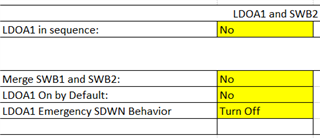

  • Hi Sandeep,

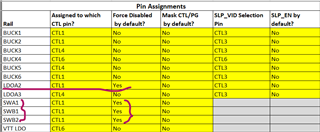

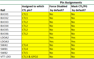

    I’m Brenda's teammate and I'll be helping you with this matter as well. Here are some next steps to take.
    Yes, In the OTP file we have set these rails to be default disable and there outputs are all Zero.

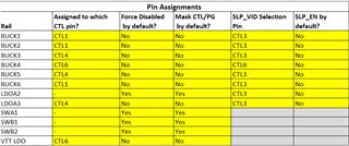

    1) I noticed in your custom OTP document, you have LDOA1, LDOA2, SWA1, SWB1, and SWB2 set to "Force Disabled by default = Yes". The picture below is from the default OTP Generator setting for the TPS65086470. For disabled rails, it is recommended to disconnect them from the CTLx signals by choosing "-" in the "Assigned to which CTL pin" column. After that, both the "Force disabled by default" and the "Mask CTL/PG by default" sections should also be set to "Yes" for the disabled rails. The device may still work without this configuration but there may be some issues with power good detection if this format is changed.

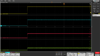

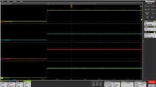

    2) Could you please take a power up capture of VSYS, V5ANA, LDO3P3, and LDO5P0. Be sure to include all 4 signals in one capture so that it is easier to compare the ramp up timings.

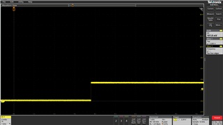

    3) Please take a separate capture of the first 3 rails that should turn on in your sequence. Include all 3 rails in one capture, along with one of the signals from step 2 above if possible, so we can compare the ramp up timings again.
  • Hi James,
    1) I shall implement this on a fresh PMIC IC and solder it on the board. Meanwhile can please review and confirm if below snap reflect your review points?
    2) Please find the requested snapshot of all 4 waveforms (VSYS,V5ANA,LSO3P3 and LDO5P0).

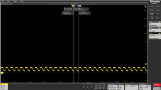

    3) Please find the requested snapshot of all 4 waveforms (LDO3P3, Buck1,Buck2 and Buck6).

  • Hi Sandeep,
    Thank you for providing those captures.
    1) Yes, that picture you shared of the "Pin Assignments" table is in line with my suggestion. Please note that the OTP can only be burned into the PMIC once. Bits that are burned as a "1" cannot be returned to "0" afterwards". Try this configuration and check the buck outputs again. If that doesn't work there are some other options.

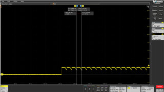

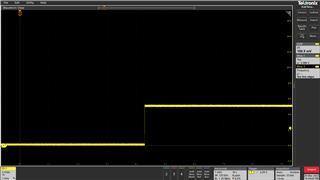

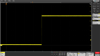

    Could you show a capture of VSYS, V5ANA, BUCK1, and BUCK2 in one image just so I can see the stable input voltage next to the buck outputs (or confirm that the above captures were taken with the bucks enabled). If the supply voltages are all stable, I'm led to believe that the issue may come from the output loads or the internal sequencing.
    3) I see that BUCK1, BUCK2, and BUCK3 all have more than one output connection. Could you disconnect all the loads and test the buck outputs? If the power fault behavior disappears then we can investigate the load conditions. What is the max load current you are expecting from BUCK1, 2, and 6?
    The periodic voltage drop in BUCK2 is propagating to BUCK1 and BUCK6 which makes sense based on your sequence programming. BUCK6 has the largest drop since it must wait for a "power good" signal from the both BUCK2 and BUCK1 before returning to the proper voltage level. I suspect that fixing BUCK2 should fix the other two regulators.
  • Hi James,
    Yes we are aware that OTP can be burned only once. Hence I mentioned in my previous reply that I will  try this with a new  part T65086470. The software that we use to burn the OTP from TI has a feature that helps in verifying if the burn OTP is matching with what we had requested into registers. So just in case the "1" that cannot be return to "0" while we burn should flag us an error while we run this step. Till now we didn't see any such errors. And also after we burned the OTP we are physically checking the power up sequence on the BOOSTXL-TPS650861 board itself and didn't find any power faults or deviation from power up sequence.

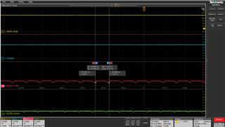

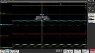

    - Waveform capture for VSYS, V5ANA, BUCK1 and BUCK2 without any power fault.
    - Waveform capture for VSYS, V5ANA, BUCK1 and BUCK2 with power fault (when we turned OFF PMIC after a long run and then turned ON without any time gap).
    - same waveform as above but reduced time scale to capture power fault time interval.
    Yes we have more than one output connection. The loads on these bucks are, (Note: as of now we have not loaded the PMIC to the max values as mentioned below)
    i) Buck1- 1.85V has a load of 1.5 Amps
    ii) Buck2 - 0.85V has a load of 7.5 Amps
    iii) Buck6 - 1.2V has a load of 5 Amps
    Before I want to disconnect these each load and check for any issue, I would like to gentle remind you that when we allow a 5mins gap after a power cycle and turn ON the PMIC, all the output rails function normal without any power fault and we kept the board running for more than 5hrs or so and didn't find any issues. We even programmed the ZU3 FPGA and kept it running for long hours and found no issues. All these hours the load remained same.
    So the question is do we really need to suspect the loads for this PMIC behavior? If so, then why after a time gap in power cycle makes everything work proper.

  • Hi Sandeep,
    Thank you for confirming the load and supply power conditions. It looks like your power supplies are stable and your loads are not drawing too much current. I am more convinced now that we are dealing with a power fault in the regulator sequence.
    • The PMIC checks for "power good" signals (PGOOD) about every 10ms. It looks like your voltage drops are occurring every ~13ms which would lead me to believe this power fault check is failing on one of the regulators and causing the rails to shutdown. When a power rail causes the fault, the PMIC only shuts down the regulators and reloads the OTP settings. After that it checks the CTL pins and tries to restart the regulators in sequence. Any of the regulators in your sequence could be sending the power fault signal. This behavior is described on page 56 of the datasheet (shown below).
      Could you provide a full register dump of all the OTP registers? Registers 0xB2 and 0xB3 (PWR_FAULT_STATUS1 and PWR_FAULT_STATUS2 respectively) could give us some insight into which rail is actually causing the power fault and resulting in all the rails to shutdown periodically.
      As I mentioned before, changing the OTP Generator table "Inputs to Enable" to the configuration I suggested might solve this issue by ensuring that the disabled rails are not being checked for a PGOOD signal. When you have implemented the new chip with the updated OTP settings, send me the new OTP Excel document for the record and let me know if the problem persists.
    • I noticed that LDO3P3 is used to pull CTL1 high with a pull-up resistor. We recommend to make sure that VSYS, V5ANA, LDO3P3, and LDO5P0 all reach a stable voltage before pulling CTL1 high. Note that the CTL1 signal is "undefined" from 0.4V to 0.85V according to the table in Section 7.12 of the datasheet (pictured below). If CTL1 is connected to LDO3P3, it may be turning on BUCK2 before the internal LDOs are at a stable voltage. BUCK2 is the most vulnerable to this issue since it only depends on CTL1 and does not look for a PGOOD signal from another regulator.
      This might explain why the PMIC functions normally for long periods of time as long as you wait 5mins after a power cycle and the start up process goes smoothly. That particular detail makes me think the issue occurs somewhere near the supply startup and CTL1. If a buck later in the sequence was the issue I don't see how waiting a long time before turning on the system would change the result. However I would still check the above mentioned registers just in case one of the later bucks is the culprit.
