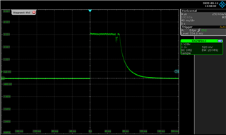

RENG waveform without playing music:

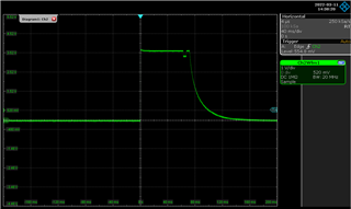

RENG waveform with playing music:
From the above two waveforms, it is found that when playing music, the REGN has riple at Hi level, and no Hi level is playing music without ripple.

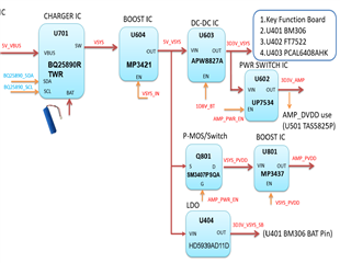

The Power map of the bluetooth speaker is as follows:
Could you help check this case? Thanks.

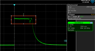

    The RENG's ripple is a little bit larger, as shown in the red box below.
    This will affect the voltage fluctuations of the TS, which will cause the BQ25890 internal ADC to detect a large error in the battery temperature. The customer would like to figure out the mechanism of the BQ25890 internal ADC. Could you help clarify this?
    The following figure is the actual measured waveform on the board, which is indeed larger:

  • Cherry,
    Referring to JEITA THERMISTOR COMPARATOR (BUCK MODE) and COLD/HOT THERMISTOR COMPARATOR (BOOST MODE) specs on the Electrical Characteristics table, it is the (VTS/VREGN)% (e.g. 44.74%) determining the temperature status, but not VREGN. The internal network is biased by REGN. The variation of REGN will be cancelled when the external network is biased by REGN. That's why Figure 14. TS Resistor Network uses REGN as pull-up, but not a random power supply.
