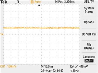

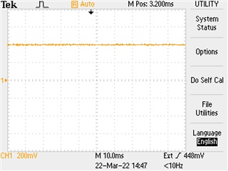

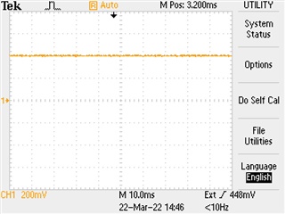

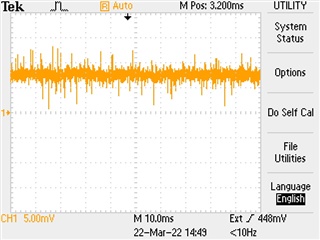

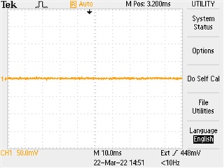

    I have attached the scope measurements from all the LM3488 pins.
    COMP:
    COMP
    DR:
    DR
    FA:
    FA
    FB:
    FB
    ISEN:
    ISEN
    VIN:
    VIN

  • Hi Charl,
    Your scope shots are not what we expected from a good IC.  It seems the IC is already damaged.  Could you replace the IC with a new and redo the test?  Please take necessary steps to prevent possible ESD destruction to the IC during handling.

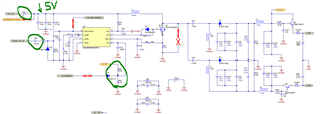

    If it isn't, I looked at the previous conversation and I think in order to figure out the issue, we can start with isolating the rest of the board with the HV circuit.
    From the schematic shown below, can you ensure that the following red crossed DNP components are indeed unmounted.
    1. Input supply Isolation: Remove R54 0 ohm and directly give 5V from external supply on input caps C22-C23. Also remove C28 marked in green to keep the IC frequency decided by R39
    2. For start may be you can reduce the output voltage to say 30V - 40V l . You can do that by reducing the R42/R45 ratio, which follows the following relation with output voltage
    Vo = (1+R42/R45) x 1.26 V
    3. Ensure that there is no short in the circuit :between input supply and gnd; between output voltage and gnd (both positive and negative).
    Let me know if you are able to bring up till this point.
