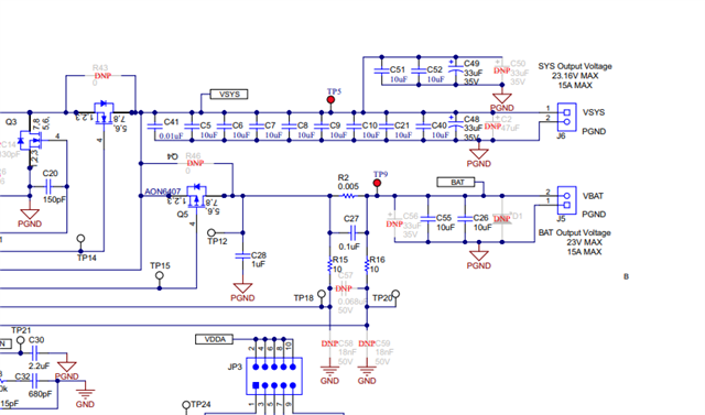

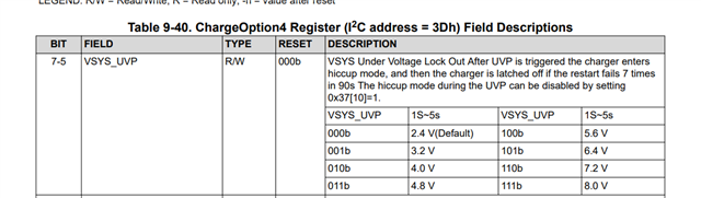

    I have a question about this parameter, is this used to protect the battery from under voltage? It seems a bit strange to me since through the internal diode of the Q5 mosfet there is no possibility of disconnecting the battery from the vsys
  • That is right, we like the battery to supplement the system instantaneously. The PFET will further turn on to lower the impedance, in times of charging and discharging. Normally, the system rail is slightly higher than the battery voltage, thus PFET remains off.
  • Thank you very much for your reply Tiger

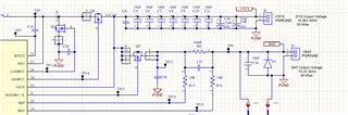

    Of course, it is very necessary that the battery is connected to the system, to guarantee a constant energy supply to it (online system), but it would also be possible to use this same circuit with a brief modification (Q5 for the circuit that I've attached below), by adding one more mosfet, it would be possible to disconnect the battery in case of emergency (over-current or under-voltage, in discharge situation (regardless of the type of battery chemistry, it could be damaged)), since these parameters are already acquired through TP19 and TP20.
    This is just a suggestion to consider into future designs, it would be an extra feature for the same IC, at no additional cost. Also, it could be enabled from a register if needed.
    This is because the protection feature is only available for OTG mode, but not in "battery only discharge and converter off" mode (when all the current is flowing through VSYS).
    Thanks again
    Lucas DS
  • Thanks for sharing your thoughts. If you want to cut off the battery path completely, suggest implementing an AC switch which is controlled by external logic (not BATDRV). There is an issue in your proposal. In battery only conditions, there is no way to turn on since BATDRV needs battery available first.
