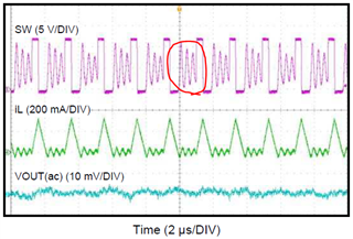

A customer asks about the oscillation of SW node waveform in DCM mode.
Can you provivde the description in detals about why it happens?

The ringing is determined by the resonant loop formed by the inductor and by the parasitic capacitances of the MOSFET and of the diode.
