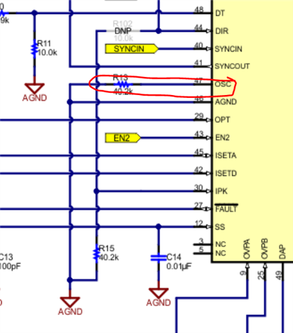

    I tired changing the switching frequency of gate signals from 100 kHz to 155 kHz, by changing the R1 and R5 resistors from 95.3 kohms to 61.9 kohms. But when I test the switching frequency on EVM, I am still able to see 100 kHz switching frequency at the gate signal.
    Is there any further changes required to increase the switching frequency?
    Test operating condition:
    Input voltage: 15 V
    output voltage: 50.5 V
    Boost operation
    Load resistor: 2000 ohms
  • Hi Jeet,
    Please note that the oscillator programming resistor is R13 on the EVM.  Yes you should also adjust R1 and R5 in accordance.
